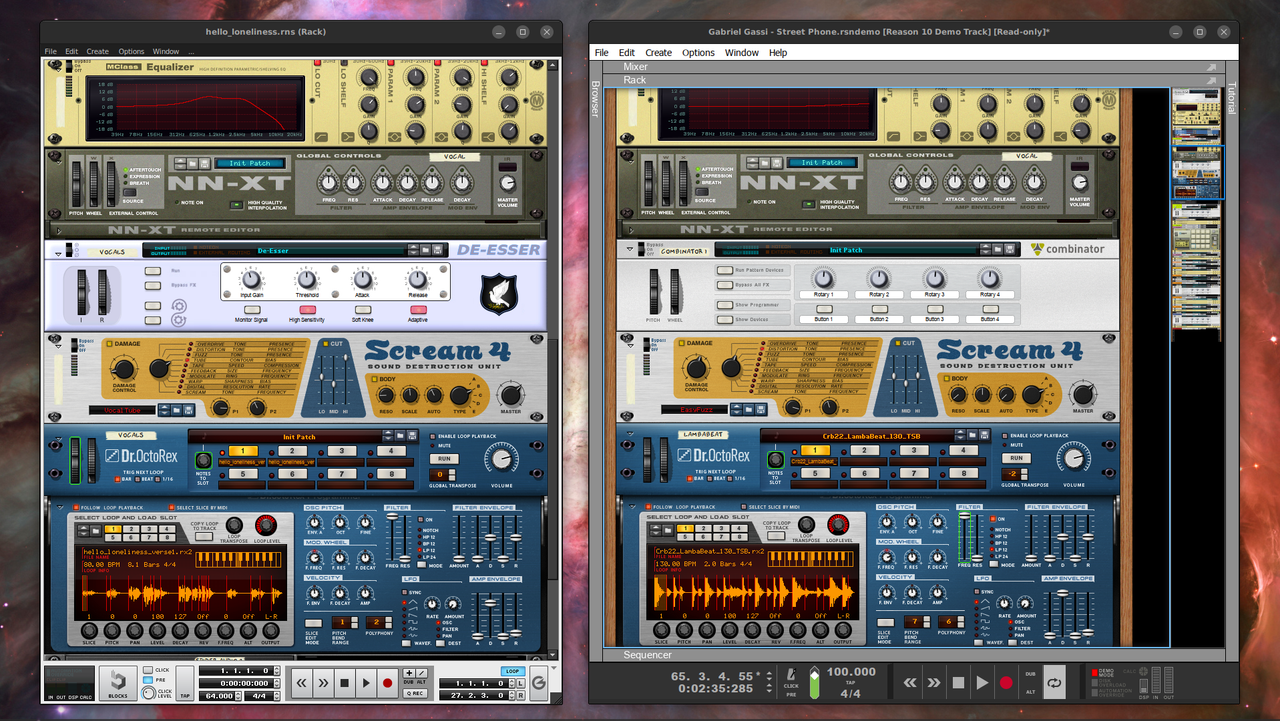

New around here, and I thought it would be nice to start a thread about Reason 5.0.X on Linux.
Running Reason on Linux is possible by using WINE. It runs fast, and makes it possible to use my favorite DAW on my favorite OS. Yes, I could get Reason 10 to run, but it was slower, and took more resources to run. I like the snappiness and speed of Reason 5, and so settled on using that.
Would like to dedicate this thread to everything having to do with Reason 5 and its compatible refills, tools, etc.
^- Screenshot of Reason 5 and 10 running side by side on my Linux machine.
