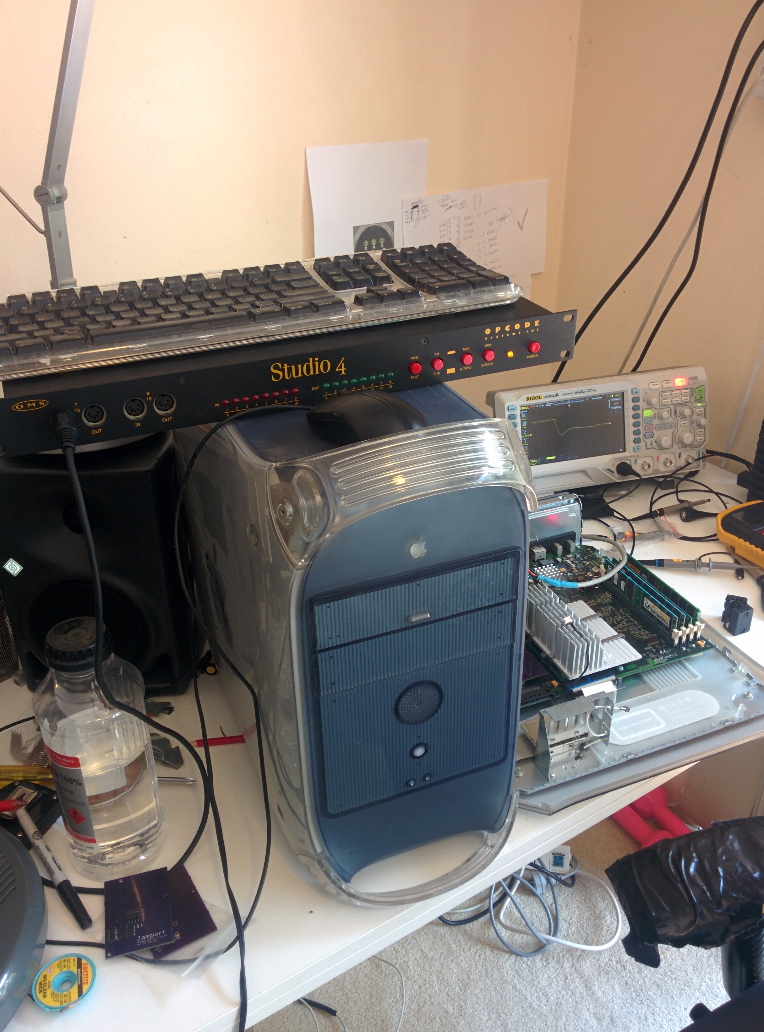

Since the GeeThree Stealth Port and the Griffin gPort are no longer manufactured, I decided to design a new serial adapter from scratch.

Powermac G4 (except PCI Graphics): 2x20 (40-pin total) connector (this is the one the Jamport uses)
Powermac G4 (PCI Graphics): from your post, it supports "iMac connector". BUT my question is, does that flex ribbon connector convert from the G3's logic board and then to the "iMac connector" on the Stealth port inside the box? Or does the ribbon just act as an extension cable?
Powermac G3: see PCI Graphics case
iMac G3: 2x35 (60-pin) connector, looks very similar to G4 connector. See attached photos (G3 logic board modem connector is near middle). I do not have the pinout for this, unfortunately, nor do I have an iMac :(
I would assume that the iMac G3 and Powermac G3 modem connectors are the same?
The photos off your phone would be really helpful! I'll have a think about the best way to reverse-engineer the port; I might PM you later about grabbing that modem or something. Alternatively, if you have a multimeter, a ruler, and a Stealth Port for your G3 already on your end we should be able to come up with a replacement part!
also thanks for this website, it's been quite useful too! Helped me find the right links to get Vision working on OS9, and finding out about the stealth port in the first place! i ended up buying one off eBay ages ago to fit in my G4 but it ended up being not working at all, so I figured, what the heck, might as well try making one myself! Can't be too hard right? ;)
