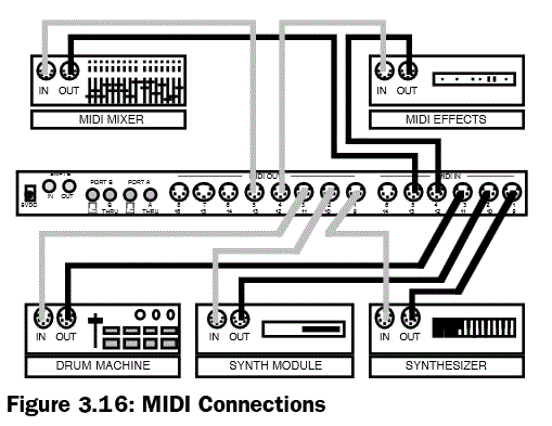

MIDI CONNECTIONS
NOTE:
If you wish to load patches from a
device into Opcode’s Galaxy program, you
must connect that device’s MIDI In and
Out ports to identically-numbered ports on
the Studio 4 (as shown in Figure 3.16)
